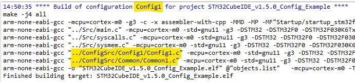

Here's the build output for Config1 showing the resources are correctly excluded:

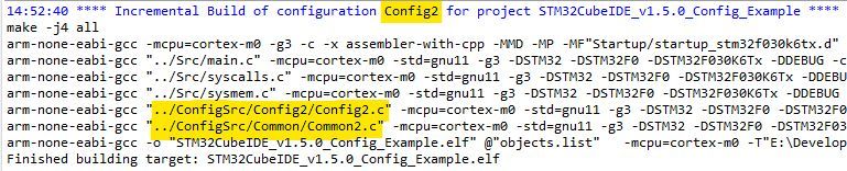

0693W000006Fpw0QAC.jpgHere's the build output for Config2 showing the resources are correctly excluded:
...but the project explorer view hasn't changed. It's still showing the excluded resources for Config1 when I expect to see the excluded resources for Config2. I hope someone can repeat this from the attached project and let me know if I'm configuring the project wrong or if there's a problem with STM32CubeIDE. Thanks for any help.

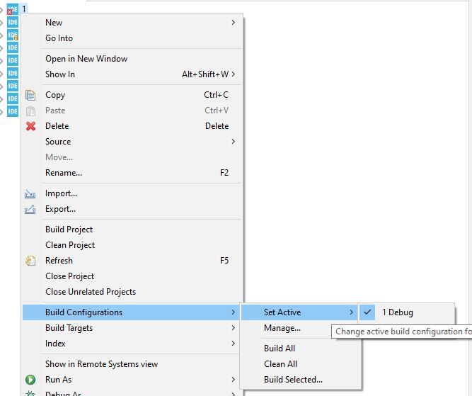

According to me common Eclipse behavior here. You not see what you're compiling if Project Tree view but active build configuration setup.
Let's play with active configuration setup (many way but project contextual project menu is good one):
