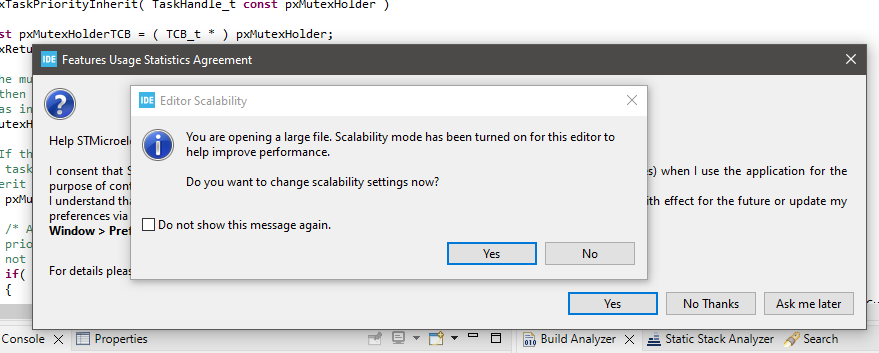

Yesterday I updated my STM32CubeIde. Today it hangs during start.
The message windows do not respond to any actions (see printscreen)
In the log files "E:\work\STM32Cube\.metadata\.ide.log" I have the following entry:
2023-02-01 08:00:55,772 [INFO] Activator:180 - !SESSION log4j initialized
2023-02-01 08:01:20,625 [ERROR] LogOutputStream:74 - [STDERR_REDIRECT] SLF4J: Failed to load class "org.slf4j.impl.StaticLoggerBinder".
2023-02-01 08:01:20,626 [ERROR] LogOutputStream:74 - [STDERR_REDIRECT] SLF4J: Defaulting to no-operation (NOP) logger implementation
2023-02-01 08:01:20,628 [ERROR] LogOutputStream:74 - [STDERR_REDIRECT] SLF4J: See http://www.slf4j.org/codes.html#StaticLoggerBinder for further details.
2023-02-01 08:11:04,816 [INFO] Activator:179 -

Creating a new workspace has worked for me.
