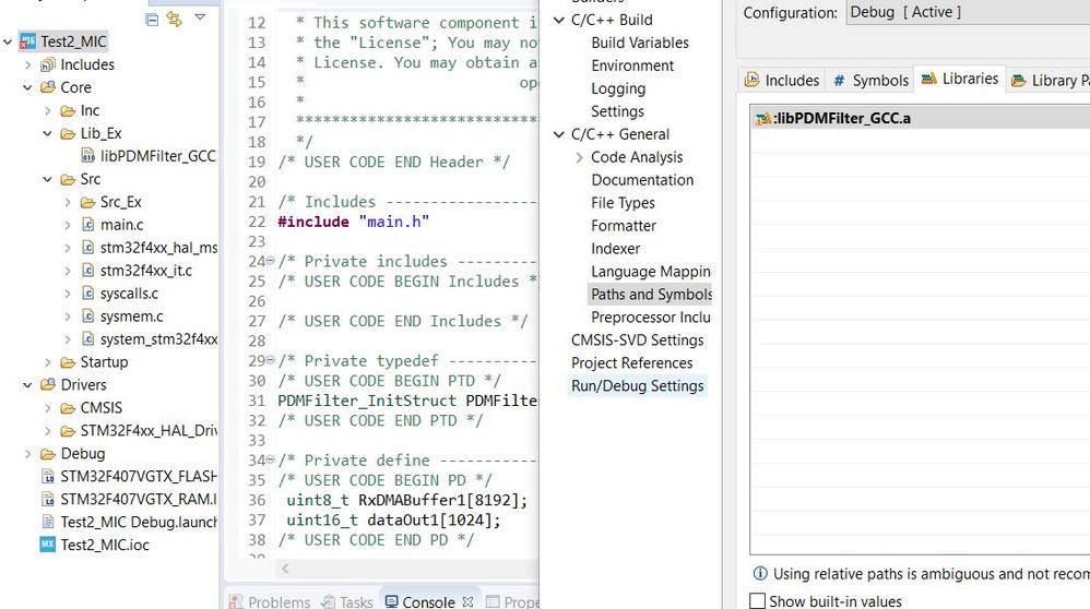

I have a problem when I add ARM DSP library, the following error appears:
c:\st\stm32cubeide_1.0.0\stm32cubeide\plugins\com.st.stm32cube.ide.mcu.externaltools.gnu-tools-for-stm32.7-2018-q2-update.win32_1.0.0.201904181610\tools\arm-none-eabi\bin\ld.exe: cannot find -lC:/IoT/../L59_stm32_examples/Libraries/CMSIS/DSP/lib/arm_cortexM4lf_math.lib
so I tried everything I know but not solved, I add the library to the project, change the name change extinction from.a to .lib, and here is some photo from my project.
Please help and thanks in advance!

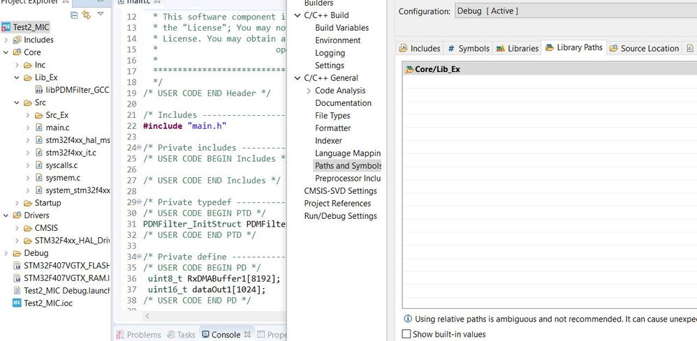

Hi �?lvaro Frutos , clive1 (NFA Crew)
Thanks a lot for your help.
I tried everything I can do, but still, nothing works!
I also tried to use the PDMFilter(AN3998)library but the same error appears..Here some photos of the new project configuration.
So I try to test use the pdm2pcm library from cubemx and it seems to work very nicely with no error..also I take a look at how the library is implemented and then I make the same thing but this not solve the problem...

2020-05-15 8:58 AM
What I did is follow the steps described in my original post to get the include files available. Then, to solve the static library not found problem I just copied the libarm_cortexM4lf_math.a file to my project (without changing the name).
Then I added it to the "Libraries" list. Notice that without the .a extension and without the lib prefix.
Finally I added the path to the library in the "Library Paths".
After this process everything worked.
