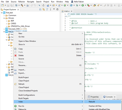

I assume TDK aks if the project builds. To rebuild your index you simply open your project explorer view, right click on to open the context menu: Index -> Rebuild
