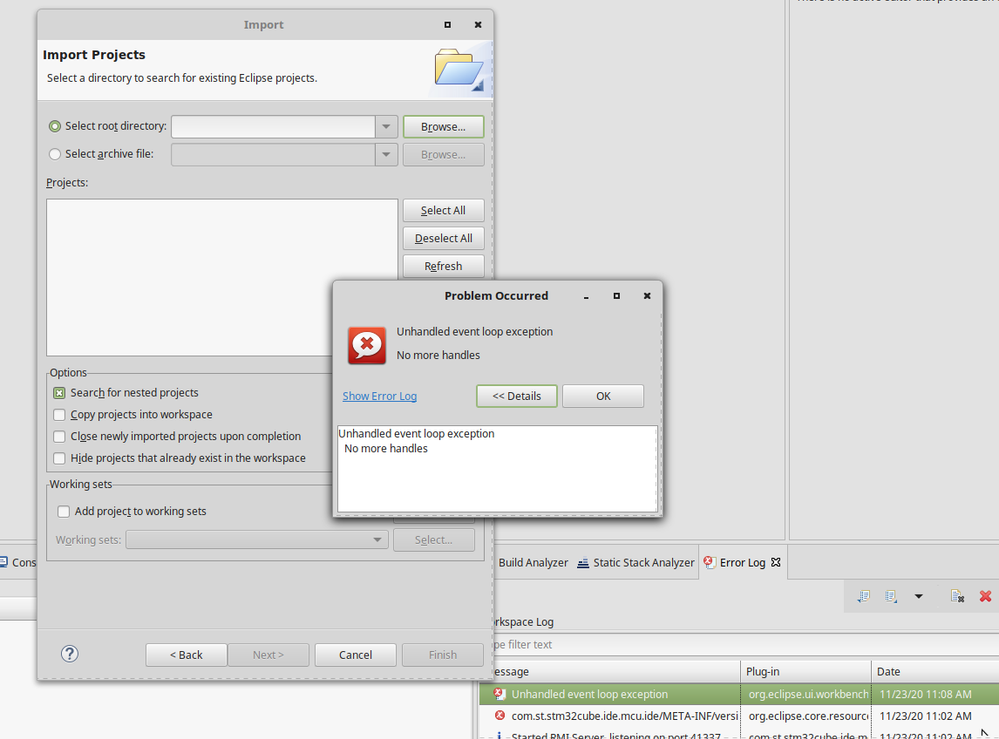

I cannot import existing project into Workspace. Here's the error log when I try to select a root directory:

Any hints?

Is this for any directory. Just after clicking the "Browse..." buttom
I've used the previous version 1.4.0 with no problems on my Linux Mint 18.3 64-bit

I've finally update my GTK+ version from v3.18 to v3.20. Now it works as expected.
