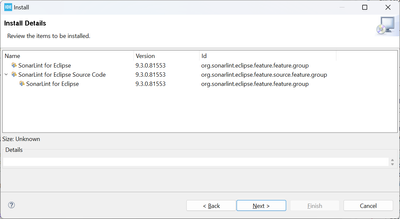

I do not know exactly why, but I had a terrible time trying to install SonarLint via Eclipse Marketplace as well. I kept getting encryption certificate related errors so finally just downloaded the ZIP directly and performed offline installation.
1. Download
org.sonarlint.eclipse.site-9.3.0.81553.zip (found among All releases)
2. Help -> Install New Software -> Add -> Archive (select ZIP)
3. Restart
See also https://stackoverflow.com/questions/5482554/how-to-install-plugin-for-eclipse-from-zip & https://community.sonarsource.com/t/installation-issue/11158/5
