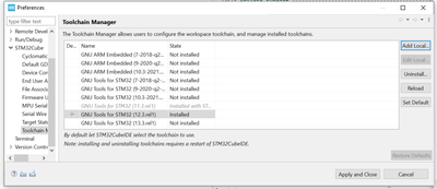

In fact, I am able to install GNU Tools for STM32(12.3.rel1) and STM32(13.3.rel1) on STM32CubeIDE 1.13.2 through the Toolchain Manger.
In this case the build is failed due to Program "nullg++" not found in PATH.

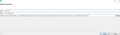

As Workaround, after installing GCC12 under this path:
C:\ST\STM32CubeIDE_1.13.2\STM32CubeIDE\plugins\com.st.stm32cube.ide.mcu.externaltools.gnu-tools-for-stm32.12.3.rel1.win32_1.1.0.202410251130.
Click on Add Local.
Prefix: arm-none-eabi-
Location:
C:\ST\STM32CubeIDE_1.13.2\STM32CubeIDE\plugins\com.st.stm32cube.ide.mcu.externaltools.gnu-tools-for-stm32.12.3.rel1.win32_1.1.0.202410251130\tools\bin
Then click on finish.
Best Regards.
Mahmoud

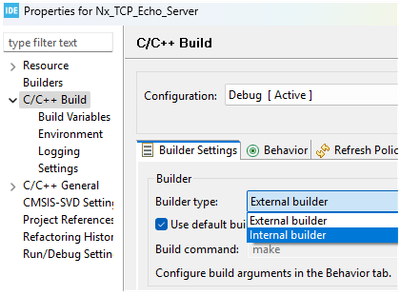

Try to switch to the "internal builder" , while waiting for more useful replies.
lmartinod
Unfortunately, External or Internal builders selection does not change anything. In both cases, the nullgcc error is present, and compilation is not possible with GCC ARM for STM32 v12.3rel1 here.

I fought with this for ages today, after a STM32CubeIDE update (1.18.0 to 1.18.1). The actual damage might have been the previous update, from 1.16.
The problem ended up being in the PATH variable, in Properties/C/C++ Build/Environment.  The actual path to the build tools was in there, but it was pointing to an older non-existent folder. It was also set to USER: CONFIG, not Build System. If I changed it to either BULD SYSTEM (delete PATH) or fixed the path, it was all working.
I had edited the path to try an add 'touch.exe' to the tool chain, which is annoyingly missing.
