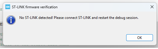

While using STM32CubeIDE I'm having a problem connecting to the device using the ST-LINK GDB server. I receive the following error message:
_legacyfs_online_stmicro_images_0693W00000bhh5NQAQ.pngTried the following to remedy the situation:

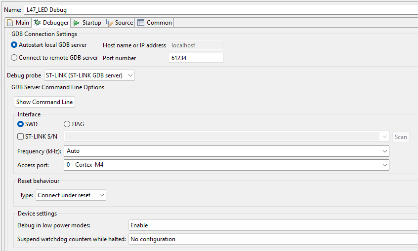

Here are the debugger settings:

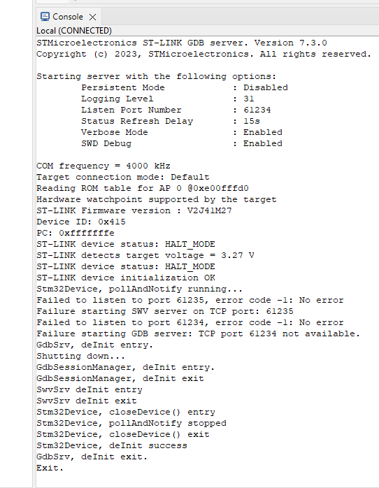

Setup a local console, manually executed ST-LINK_gdbserver and STM32_Programmer_CLI and received the following:
_legacyfs_online_stmicro_images_0693W00000bhhCjQAI.pngAllowed gdb_server through firewall, tried to enter debug mode again and still received the same error message. Assistance would be appreciated.

Hello @vicsimdelay​
No ST_LINK detected please connect ST_LINK and restart the debug session
This message appears when you have a connection problem so try to change the cable or the port cable and tell me what's up

The issue was traced back to the internet kill switch.
