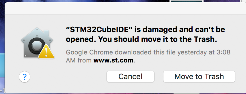

STM32CubeIDE 1.1.0 don't start on a Mac OS.
jihzed
FileVault can't open check the application : "STM32CubeIDE.app is damaged and can't be open. You should placed it in garbage" (translated from french, don't sure all the world in english MacOS).
Mac OS 10.14.5.
I've the admin right and I can install, it's not the problem, and I've allow the start in System Preferences.
It's like a corrupted file.
1st picture : check of application by system ; 2nd picture : alert message.
EDIT : the version 1.0.2 of STM32CubeIDE looks run. For moment I will use it. The problem is for 1.1.0 only. The CubeMX interface is not compatible with 1.1, and it's not possible to exange project.

0693W00000FAvmvQAD.pngHello,
I'm facing same issue to open st-stm32cubeide_1.7.0_10852_20210715_0634_x86_64 on my mac os Searra 10.12.6.
Any help please...
Oh! Wow!
trying
sudo xattr -cr /Applications/STM32CubeIDE.app
Copyed from tstel.1 and it worked immediately!
Thank you so much.
