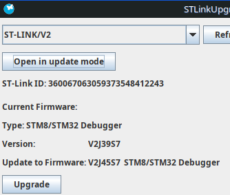

Hello, while trying to flash some test code, I have to run update on STLink, but the "Upgrade" button is not clickable...?
I have my board connected, I can see is using lsusb command on my Ubuntu...
"Open in update mode" also doesnt give any proper output,
BR

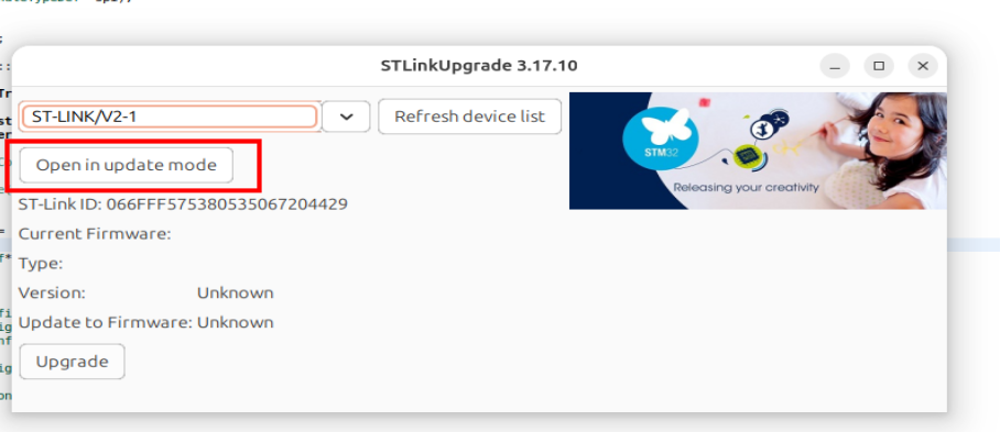

Andrew Neil
Did you click the 'Open in update mode' button?
You need to do that first - before you can do the actual update.

after executing Open in Update mode -> update is still not clickable, I am loosing connection to my STM32 board and have to replug...
did you ever update this st-linkV2 with success ?

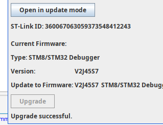

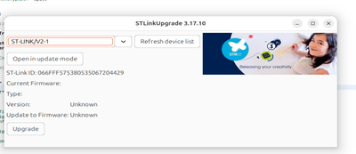

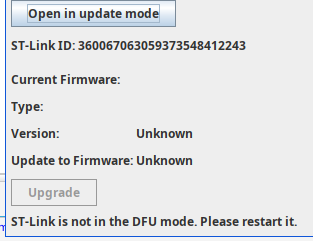

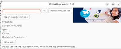

after open update mode, you might get :
- then un-plug/re-plug the st-link from usb, then refresh, open update mode again, you get:
- then upgrade, you get
