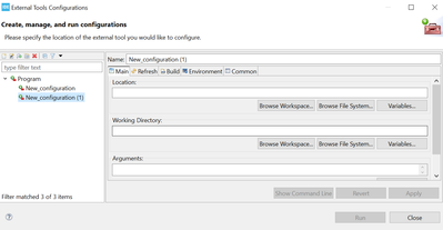

To automate the process of starting Renode and its GDB server from STM32CubeIDE, you can utilize the External Tools feature within the IDE. This allows you to create a configuration that will run scripts or commands before starting the debugger. Here’s how you can set it up:
Automating Renode and GDB Server Start
1- Create a Script:
Write a script (e.g., a shell script or batch file) that:
Starts Renode.
Starts the GDB server within Renode.
Waits for the GDB server to be ready.

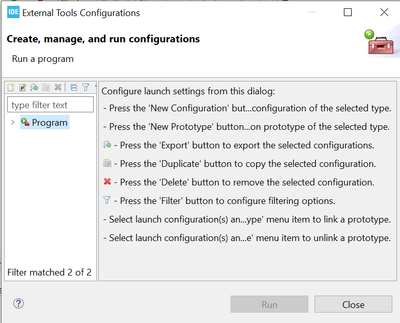

2- Configure External Tools in STM32CubeIDE:
Go to Run > External Tools > External Tools Configurations....
Create a new configuration for your script.
Set the location of your script and any necessary arguments.
3-Set Debug Configuration:
In the Debug Configurations window, under the Debugger tab, select Connect to remote GDB server.
Specify the GDB server address (usually localhost with the appropriate port).
4- Run the External Tool Before Debugging:
Before starting your debug session, run your external tool configuration to start Renode and its GDB server.
Close Renode After Debugging
