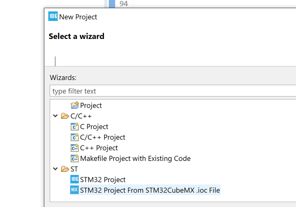

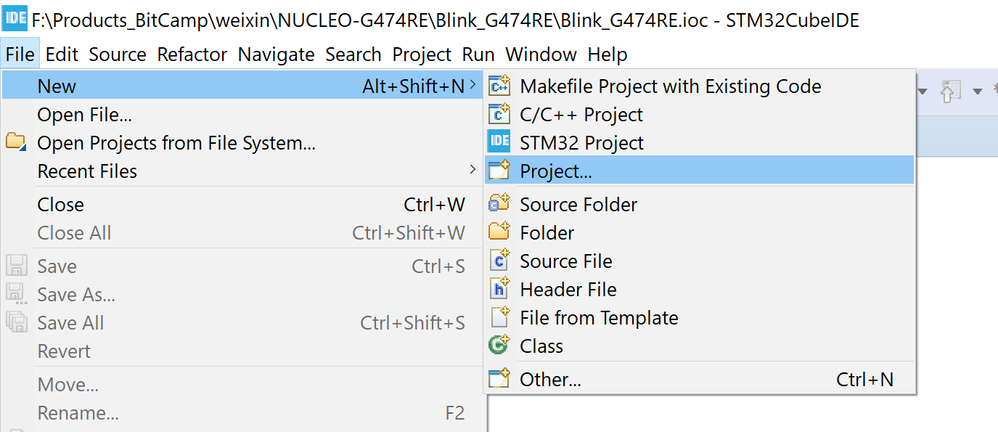

‎2020-02-18 6:22 PM
This solution works.

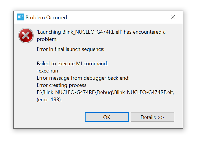

‎2020-02-19 2:48 AM
When I clicked this button,
this error prompted.
How to fix it?
