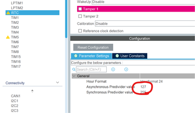

I use STM32CubeIDE and the RTC of my uC. Everytime I change something on STM32CubeMX the code is regenerated and I know that I must write my personal code in the USER SECTIONS. My question is that I want to change parameters in the initialization part that is always regenerated such as Async/syn prescaler value and RTC time. Do I have to create another function like User_init() to rewrite my parameters and the two functions will coexist or is there any other way to avoid always having to modify this initialization function, which will always be regenerated?
There is the STM32CubeMX initialization and the init I want :

 Thank you for your help !

You can add, what you want, in the
" /*....user code begin/* >write here the init call with your parameters again ! < /*..*/
see my example here, to change rx/tx pins:

just copy + modify the "...init" + put in user code area !
Change the predividers in the IOC file.
You cannot modify code outside of the USER CODE sections and have it be preserved through new "generate code" calls.
mƎALLEm
Either you make this changes in CubeMx each time you have to make the change then yiu generate the code.
Or, in USER CODE you do again the init but you need to ensure you execute the Deinit in msp file that have to contain a correct De-initialization of the peripheral.
