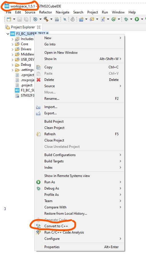

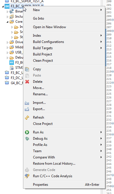

I am right-clicking on the project heading, not the individual file. The Convert option used to be there, so I know where it "SHOULD" be.
How can I upload the project? Can I just zip it and attach it here? Let's see if it works.
Here is my menu. Hope it is readable.

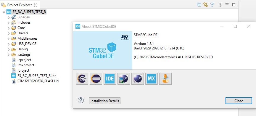

Based on your .zip ... just importing it ... works for me

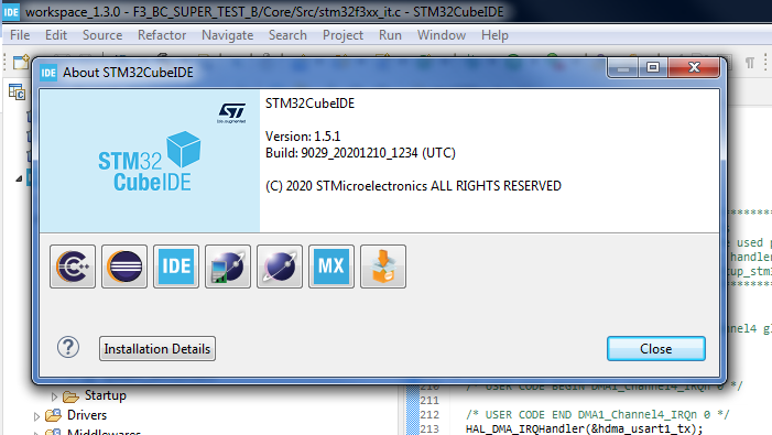

I might see it. My workspace reports as 1.3.0 while yours shows 1.5.1 . I think this is just a name.
I'll look into upgrading, or maybe de-installing and re-installing the IDE.
Mine. Not able to explain but yes maybe fresh install & fresh workspace may help sounds you've locally something weird ...

Fixed. Uninstalled and reinstalled in a different directory. After I imported te hold projects, i now see the Convert to C++ option.
Thanks for your help. I did have to let the installer place the IDE in the director of its choosing, not where i would like it to be. I tried to put it in my Engineering directory and the project import process barfed. After another uninstall/reinstall, and import, it works fine.
