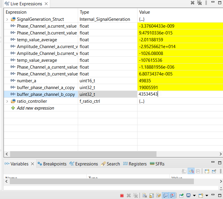

I use STM32CubeIDE version 1.14.1. When I'm in debug mode, the Values in the "Live Expressions" window are weird and wrong.

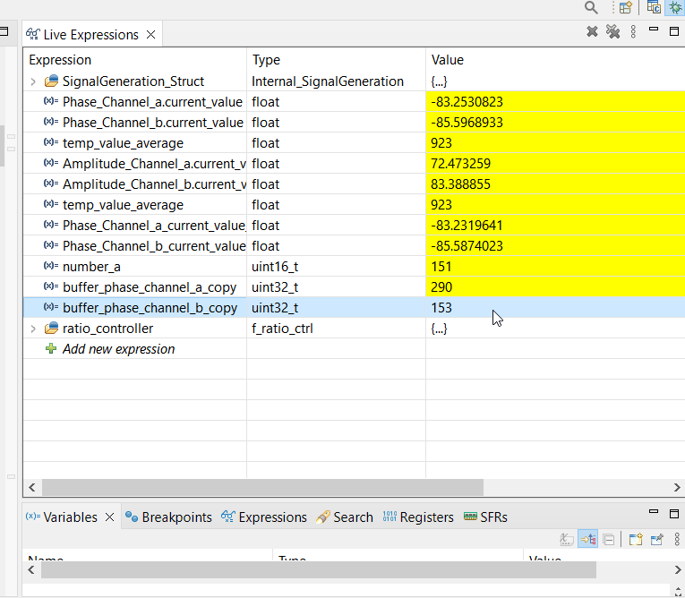

However, I found out that after editing and putting a random value in one of the fields, it will be fixed.
Beginning:
After writing a number:
Solved! Go to Solution.

Hello @ali rostami
Thanks a lot for your contribution.
This issue has been already reported to our STM32CubeIDE development team in this ticket 175214 and this will be fixed asap.
I'll keep you informed.
