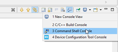

After one of the program updates, the "Command Shell Console" stopped opening.
As usual, I click on "Open console" button, then on "Command Shell Console", but nothing happens.
I rebooted the computer, restarted the program. But nothing changes - just no reaction.

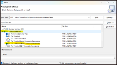

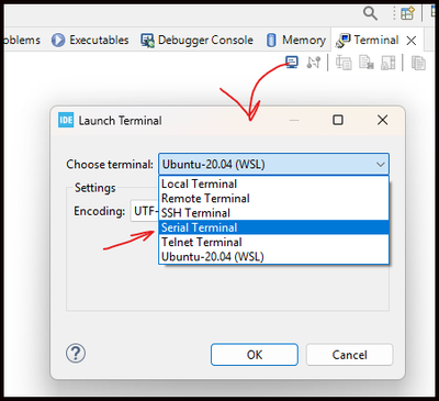

2024-12-12 5:50 PM - edited 2024-12-12 5:57 PM
> No dialog appears with port selection, etc.
Aha, you probably want the serial terminal. It has been reorganized during Eclipse development.
Now this thing belongs to the "Terminal features". If it is not installed you can add it via Help-> Install new software.
After it is installed: Select the Terminal view (Window->Show View-> Terminal)
And click on the toolbar icon. This will present you selection of all terminal types, including the serial.

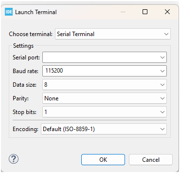

2024-12-12 3:28 PM - edited 2024-12-12 3:31 PM
Really, not a single answer? Technical specialists, Сube developers, where are you?
I even reinstalled the СubeIDE just now, it didn't have any effect. Everything is the same - just nothing happens when I try to open the console. No dialog appears with port selection, etc.
2024-12-13 3:38 AM
Thank you!
It works now.
