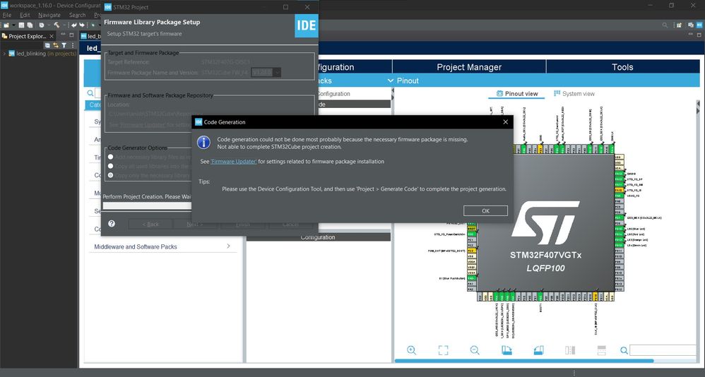

I installed STM32CubeIDE and have been trying to create a project using the STM32F407G-Discovery Board.
Upon trying to create a project, the startup code generation file doesn't show up.

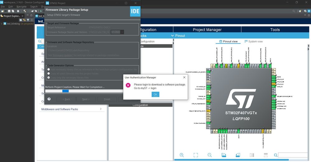

I get the following pop-ups. I am unable to resolve this issue.
What am I supposed to do here?
What do I need to download
‎2024-07-30 2:35 AM
So did you login and download the firmware package?
‎2024-07-30 3:49 AM
which firmware package should I download and how?

Hello @anishac and welcome to the community,
To solve this problem, check the connection under Window->Preferences->Firmware updater, then login to myST. The firmware for F4 will be successfully downloaded.
Thanks,
Rim.
‎2024-07-31 10:35 AM
Hi @Rim LANDOLSI ,
I did download the F4 package and added it to the repository folder, and tried creating a project and the same issue came up again. Unable to figure out why though.
