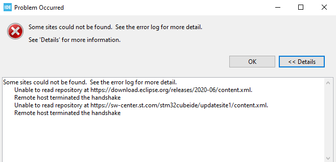

I have two machines with Cube IDE installed. On one there is version 1.6.1 and the other is 1.7.0
I want to update both to be able to open .ioc files from a college that has the 1.8.x
The proxy settings are setup rigth because i am able to get the newest embedded software packages updates.
But if i try to check for updates of cubeIDE i get following errors on both machines:

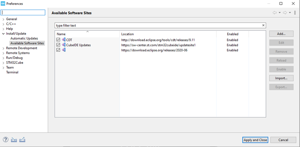

This are my settings for repositories:
Hope some one can help me to figure out my mistake.

Just in case... You can always download and update it manually.
‎2022-02-11 3:28 PM
‎2022-02-11 3:44 PM
Some kind of AV or firewall?
Need to use a proxy server?
‎2022-02-14 11:45 PM
Thank you, i did it manually.
