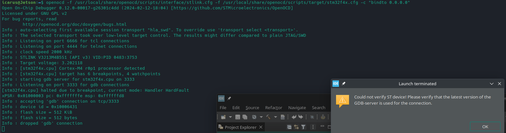

I'm having an issue being able to remotely deploy my firmware using my Nvidia Jetson Nano (ARM based SoC) with an STLink v3 mini and OpenOCD. The MCU I've bought is genuine (from Farnell) and I have no issues programming my board locally (i.e connected my board to my development machine).
I'm able to connect OpenOCD to my chip and erase it. However, when I come to deploying any firmware, I get the following message:
Could not verify ST device! Abort connect.
The GDB server shows a connection is being established but is closed straight after. The MCU is a STM32F411CEUx
Any help please? I've attached a screenshot here:
