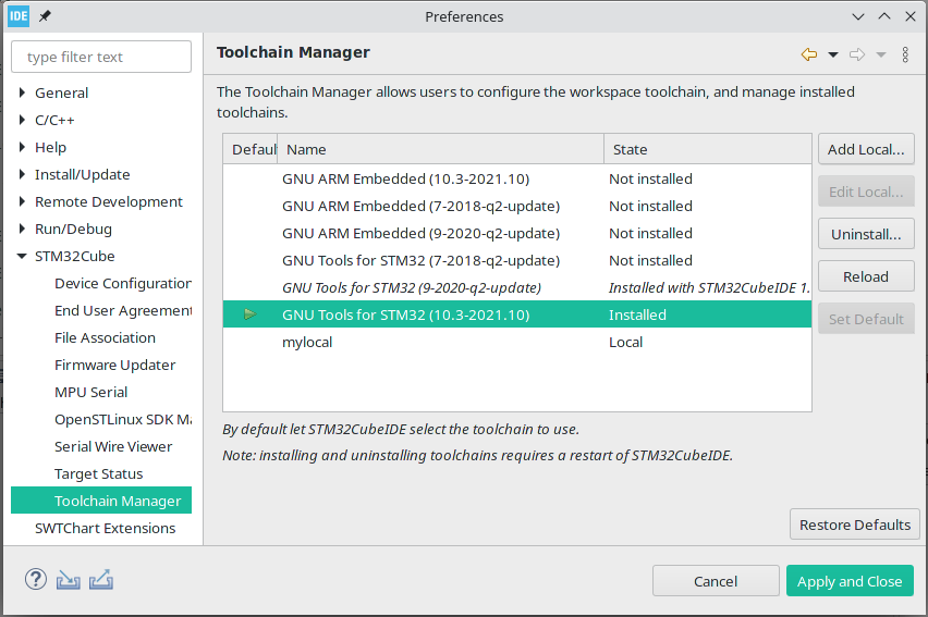

2024-03-26 9:09 AM - edited 2024-03-26 11:05 AM
On Ubuntu 23.10 I encountered the same problem, but `libncurses5` cannot be installed anymore.
New Solution:
`sudo apt install gdb-multiarch`
And then, like shown some posts ago, go to "Window" -> "Preferences" -> "STM32Cube" -> "Toolchain Manager" -> "Add Local" and set it up like this:
Then "Set Default" on this new entry.
2024-03-26 9:57 AM - edited 2024-03-26 11:06 AM
My solution doesn't survive a program restart. Any idea, why and how to fix? And it doesn't build anymore.
2024-03-26 10:35 AM - edited 2024-03-26 2:24 PM
So, I made a quick, ugly workaround:
sudo -i
apt install gdb-multiarch # as mentioned before
cd /opt/st/stm32cubeide_1.15.0/plugins/com.st.stm32cube.ide.mcu.externaltools.gnu-tools-for-stm32.12.3.rel1.linux64_1.0.100.202403111256/tools/bin # or wherever you installation is
mv arm-none-eabi-gdb arm-none-eabi-gdb.bak
ln -s /usr/bin/gdb arm-none-eabi-gdb
With this, building AND debugging works again on Ubuntu 23.10.
