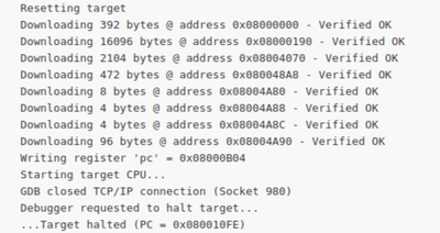

I would like to use SEGGER System View. In order to achieve that I need to convert ST-Link to J-Link firmware. have followed instructions here.
Then, I have performed below configuration.
In order to make sure whether conversion is OK or not, I flashed my application via J-Link. Please see the console output attached.
I can not see that my code is run on the board.
Could you please point me to the right direction ?
Thanks.
4 REPLIES 4
AScha.3
seems ok to me :
program..verify...ok.
+ halt target.
So you need to "run" in debug or try reset-button to start cpu again.
Thanks @AScha.3 but that didnt work.
Please see the code below. I dont see the expected output on serial console (TeraTerm).

How is uart2 connected to PC ?
Did it work with st-link ?
Yes indeed it works with ST-Link.
