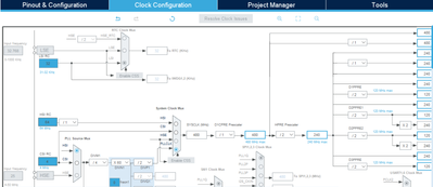

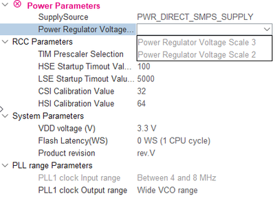

In the device configuration tool for the STM32H755 I'm not getting all the power voltage source options, severely limiting the clock speed of the CPU.
For some reason the options that are there are grayed out, and I'm missing 1 and 0.

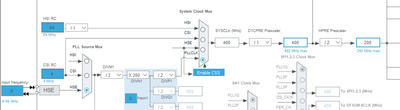

My clock configuration looks like this
Anyone have any idea how to fix this?

just you cannot choose every combination supply -> speed ; for highest core speed need volt.scale 0 (or 1) and supply LDO setting. with "direct smps" cannot take all.
Hello @tomseli
VOS0 (power scale 0) is not available when the SMPS step-down converter directly supplies VCORE. (datasheet section 6.3.1)

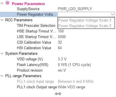

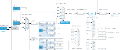

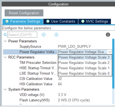

I'm getting the same options with LDO. When looking in RM0399, section 6.3.1 I see the ART accelerator. To which datasheet are you referring?
