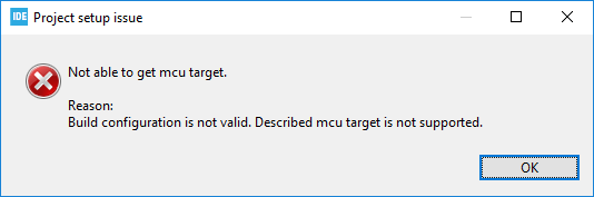

Some time ago I created a static library project in AC6 System Workbench for STM32. The project expanded and I started to adding build targets for more microcontrollers, STM32L, STM32F7, etc. After migrating the project to Cube IDE I am no longer able to select a target microcontroller in Build Targets configuration. I tried to create a separate static library project in Cube IDE directly but there is no option in New Project wizard to select the microcontroller. What is more, after completing the steps in the wizard I get this:
I don't wont to start a new project in the end, if there is possibility I would like to add more configurations to my migrated static library project. How can I do that?
