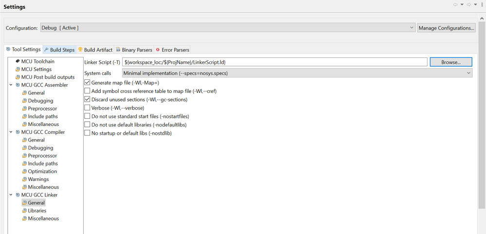

​Hello @Icont.1​ ,
Make sure that you have the correct linker script path.
You should set properly Under "Linker Script" the right path in CubeIde (Properties->C/C++ Build ->Setting ->Tool Settings->MCU G++ Linker ->General).
You can share a screenshot if your issue is not resolved.

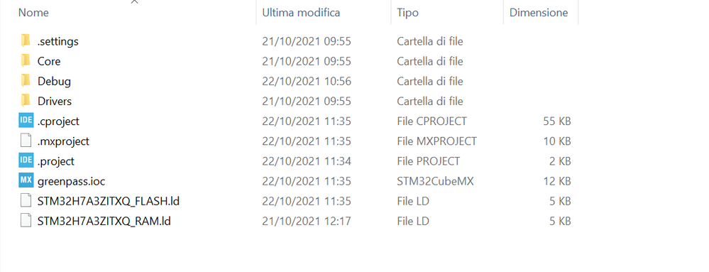

the screen of the setting is this but in the project folder I have no reference to anything about the linker. Which file or folder should I go to recover and insert to fix the problem?0693W00000FDQnjQAH.png0693W00000FDQm2QAH.png

The two *.ld files are linker files. By default, it should be using the one that ends in _FLASH.
Including the full error message would be helpful. The linker command will specify the filename it's using and trying to find.

thanks I solved by manually setting as linker the file *.ld (FLASH) from the settings.
