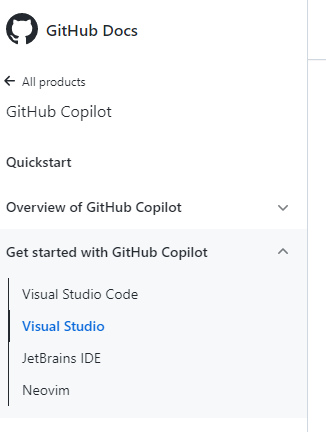

I am trying to use github COPILOT, not git. As stated in the linked post the accepted solution is no longer working.
It looks like stm32CubeIDE does not have a copilot extension currently.
There is an Open source project for eclipse though...does that work? https://github.com/masecla22/eclipse-github-copilot-integration
