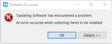

When I try to install SonarLint from Eclipsemarkete place I get the following error
Unable to read repository at https://eclipse-uc.sonarlint.org/content.xml.
Certificate chain is not valid
STM32cubeIDE 1.7.0 on Windows
I asked the question on the SonarLint forum and they provided a link to the zip archive. The offline install went fine.
I don't know if it is a SonarLint error og STM32cubeIDE error.

I don't believe this has anything to do with STM32CubeIDE. We don't really do anything to the Eclipse Marketplace from our side. Users are free to use it as they please.

I tried to install sonarlint 10.1 on STM32cubeIDE 1.7.0 on Windows using eclipse marketplace as well as using offline .zip file.
In both cases I am getting error for installing dependencies.
it allows to install sonarlint v5.0 and below without any issue.
