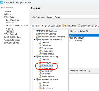

The defines and include directories used during compilation are shown in project properties. Right click on the project to access project properties. You should match those. They are also shown during compilation on the console tab.
If you still run into errors, read those error messages and let that guide what you need to change.

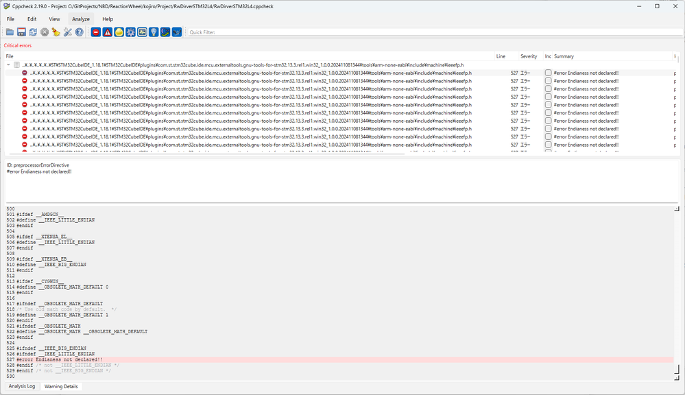

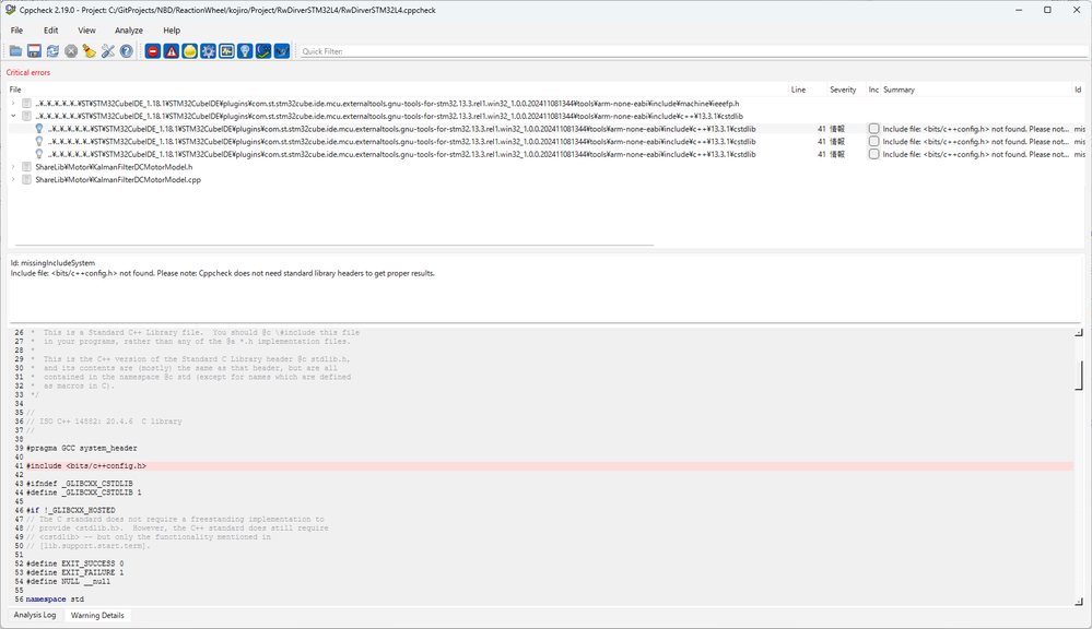

JE2Author
February 18, 2026
I have already added those.
I have added images of the CppCheck error.
Please look at those photos.
I have already added the following toolchain folders to include Paths.
  • C:\ST\STM32CubeIDE_1.18.1\STM32CubeIDE\plugins\com.st.stm32cube.ide.mcu.externaltools.gnu-tools-for-stm32.13.3.rel1.win32_1.0.0.202411081344\tools\arm-none-eabi\include\
  • C:\ST\STM32CubeIDE_1.18.1\STM32CubeIDE\plugins\com.st.stm32cube.ide.mcu.externaltools.gnu-tools-for-stm32.13.3.rel1.win32_1.0.0.202411081344\tools\arm-none-eabi\include\c++\13.3.1\
  • C:\ST\STM32CubeIDE_1.18.1\STM32CubeIDE\plugins\com.st.stm32cube.ide.mcu.externaltools.gnu-tools-for-stm32.13.3.rel1.win32_1.0.0.202411081344\tools\lib\gcc\arm-none-eabi\13.3.1\include\
These may be incorrect.
I searched for “c++config.h” and tried to add it to the include path, but there are multiple versions depending on the ARM toolchain version, and I wasn’t sure which one I should select.
Do you have any additional advice after looking at the images?

I finally managed to solve this problem on my own.
I checked the Predefined Macros using the GCC compile options “-v -dM -E”.
I was finally able to do it by adding the following.
Defines:
__cplusplus=201402L
__cpp_ref_qualifiers=200710L
__INTPTR_TYPE__=int
__INT32_TYPE__=long int
__GNUC__
__VFP_FP__
__IEEE_LITTLE_ENDIAN

Include Paths:
C:/ST/STM32CubeIDE_1.18.1/STM32CubeIDE/plugins/com.st.stm32cube.ide.mcu.externaltools.gnu-tools-for-stm32.13.3.rel1.win32_1.0.0.202411081344/tools/arm-none-eabi/include/newlib-nano/
C:/ST/STM32CubeIDE_1.18.1/STM32CubeIDE/plugins/com.st.stm32cube.ide.mcu.externaltools.gnu-tools-for-stm32.13.3.rel1.win32_1.0.0.202411081344/tools/arm-none-eabi/include/c++/13.3.1/
C:/ST/STM32CubeIDE_1.18.1/STM32CubeIDE/plugins/com.st.stm32cube.ide.mcu.externaltools.gnu-tools-for-stm32.13.3.rel1.win32_1.0.0.202411081344/tools/arm-none-eabi/include/c++/13.3.1/arm-none-eabi/thumb/v7e-m+fp/hard/
C:/ST/STM32CubeIDE_1.18.1/STM32CubeIDE/plugins/com.st.stm32cube.ide.mcu.externaltools.gnu-tools-for-stm32.13.3.rel1.win32_1.0.0.202411081344/tools/arm-none-eabi/include/c++/13.3.1/backward/
C:/ST/STM32CubeIDE_1.18.1/STM32CubeIDE/plugins/com.st.stm32cube.ide.mcu.externaltools.gnu-tools-for-stm32.13.3.rel1.win32_1.0.0.202411081344/tools/lib/gcc/arm-none-eabi/13.3.1/include/
C:/ST/STM32CubeIDE_1.18.1/STM32CubeIDE/plugins/com.st.stm32cube.ide.mcu.externaltools.gnu-tools-for-stm32.13.3.rel1.win32_1.0.0.202411081344/tools/lib/gcc/arm-none-eabi/13.3.1/include-fixed/
and
my projct paths(like ./include, ./sharelib, ...)
