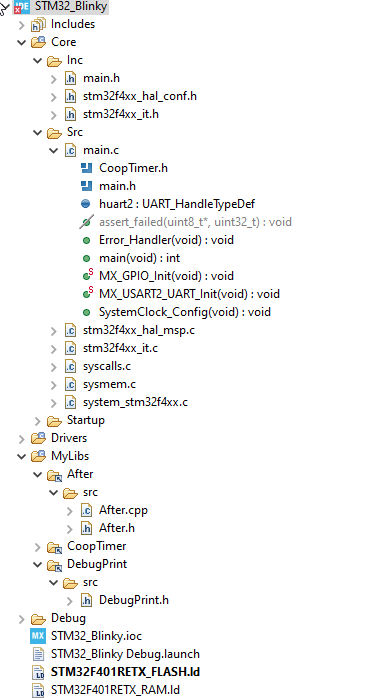

- right clicking on the project  I created a new source folder "MyLibs"
By drag and drop I copied my library called "After" folder into the new MyLibs folder. Answered the message by "copy link only" into the new folder "MyLibs"
The copied folder "After" contains an other folder "src" where the source files are located. Here a picture of the project:

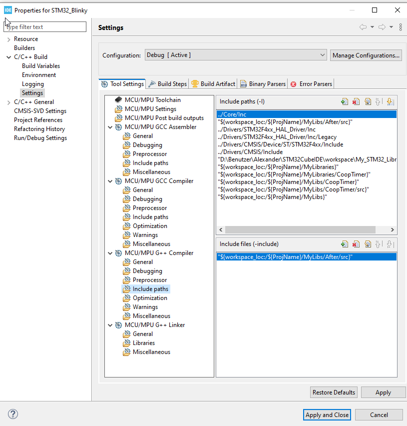

Now I go to properties and set the include path to the directory /MyLibs/After/src/:
The second line indicates that I have included the directory successfully.
When comiling I get the error message:
<command-line>: fatal error: D:/Benutzer/Alexander/STM32CubeIDE/workspace/My_STM32_Libraries/After/src: No such file or directory
compilation terminated.
So it seems the files are not found.

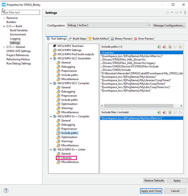

Hello @DocAlex, welcome to ST Community,
The library (.a) should be added under Project > Properties > C/C++ Build > Settings > Tool Settings > MCU GCC Linker > Libraries:
and under MCU GCC Compiler > Include paths add the path to the header files.

@DocAlex The include paths changes should be under GCC compiler, not G++ because your source files are not C++. If not sure, add the include paths in both places.
Also check: MyLibraries or MyLibs ?
