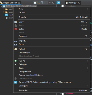

I used Rowley Crossstudio for STM32L011 development so far but wanted to try the CubeIDE as well.
But upon generating a fresh STM32 project and importing my c++ files from my directory, I can't build the project because in the properties there is no c/c++ builder option present.
How can I solve this or properly setup my project?

To use C++ sources, convert your new CubeIDE project to C++. Right click on the project in the Project explorer pane and select "convert to C++". This will enable the C++ compiler and linker.
Next, please read the CubeIDE user manual on creating and importing projects. This manual is available in Help-> Information center-> STM32CubeIDE User guide.

I set up the project already as "C++" in the "STM32 project" wizard when I generated it.
Or do you mean somewhere else? Because there is no "Convert" option in the right click menu:

Hmm. Strange.
Try to import some example and see how it looks in the Project explorer pane.

so you started new project as C++ . ok.
It will do it then...need nothing to adjust. BUT main.c still C , but should be no problem.
See : you setup cpu with Cube/HAL , all is in C. So just add your c++ files (-> import..c++ + .h files ), then it should work. Compiler is in C for the start/init in main, and C++ for your added files, linker puzzles it together.
Try..
