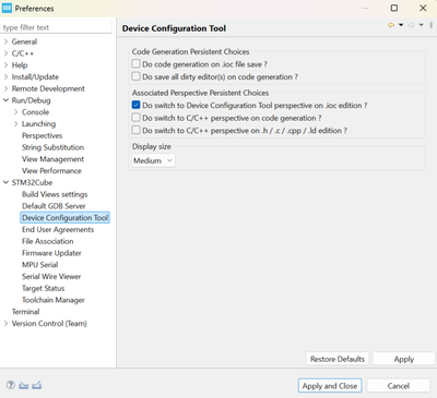

1. I want ti have auto view change for C, MX and Debug windows. Previously a promt used to come. Now I dont see that.
2. I want to generate MX automatic on save. Previously a promt used to come. Now I dont see that.

As far as I know, these features are already available in the IDE. If you are no longer seeing prompts for automatic view changes between C, MX, and Debug windows, or for automatic MX code generation on save, it’s possible that the relevant settings have been changed or disabled.
I recommend checking the IDE’s preferences to ensure these options are enabled:
1- Go to the menu bar and select Window > Preferences.
2- In the Preferences window, expand STM32Cube in the left panel.
3- Review the available options for view switching and code generation, and enable or adjust them according to your preferences.
