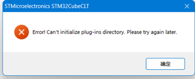

各位开发者好,
我在安装 STM32CubeCLT(版本:st-stm32cubeclt_1.19.0_25876_20250729_1159_x86_64.exe)时遇到问题,具体情况如下:
  1. 环境信息
    • 作系统:Windows 10 64 位(版本 22H2)
    • 安装包来源:ST 官网下载
    • 安装路径:D:\STM32CubeCLT(纯英文,无特殊字符)
  2. 问题现象
    • 双击安装包无响应 / 弹窗报错(此前尝试图形化安装失败);
    • 尝试管理员身份运行 CMD,执行静默安装命令 ,命令行无明显报错,但安装目录未生成、等关键文件夹,确认安装失败。st-stm32cubeclt_1.19.0_25876_20250729_1159_x86_64.exe /Sbin插件_0-1755742850724.png
  3. 补充说明
    • 首次安装该版本,无旧版残留(已手动清理可能的遗留文件);
    • 安装包校验过 MD5,确认完整无误。

Hello @贰黑
I used Reverso to translate your post.
I encountered an issue while installing STM32CubeCLT (version: st-stm32cubeclt_1.19.0_25876_20250729_1159_x86_64.exe). Here are the details:
Environment Information
Operating System: Windows 10 64-bit (version 22H2)
Installation Package Source: Downloaded from the official ST website
Installation Path: D:\STM32CubeCLT (English only, no special characters)
Problem Description
Double-clicking the installer does not produce any response or error message (previous attempts to run the installer also failed).
Running the installer from an elevated Command Prompt (as administrator) with the silent installation command does not show any errors, but no installation directory or key folders are created, confirming the installation failed.
Command used:
This is the first time installing this version, and any possible legacy files have been manually removed.
The installation package was verified using MD5 and is confirmed to be complete.
Actually I was capable to install the STM32CubeCLT (version: st-stm32cubeclt_1.19.0_25876_20250729_1159_x86_64.exe) on a windows10 machine  which suggests that the issue may be specific to your environment.
To resolve the STM32CubeCLT installation issue, please try the following steps:
1- Check Windows Security Settings: Ensure the installer is not being blocked by Windows security settings or antivirus software.
2- Run as Administrator: Right-click the installer and select "Run as administrator."
3- Change Installation Directory: Try installing to a different directory (e.g., C:\STM32CubeCLT).
4-  If you have access to another PC, try installing STM32CubeCLT there to see if the issue is specific to your current system.
