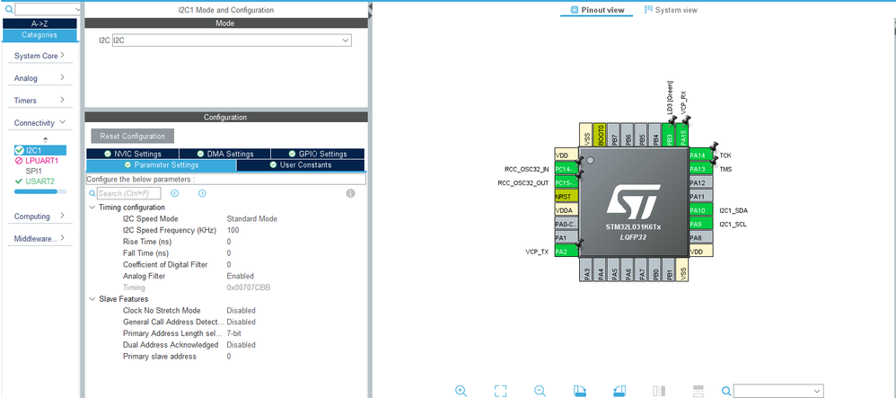

I used STM32L031K6 Nucleo board.
When I Enable I2C it select by default PA10(SDA) & PA9(SCL) pins for Communication it not work, Then I change Pins for I2C PB7(SDA) & PB6(SCL) it work well.
so any additional configurations need for use PA10 & PA9 pins ?

Hi @Rushit
No additionnal Configuration required.  Can you confirm me that your GPIOs are in pull up mode?

Hi @Diane POMABIA
Yes I try with software pull-up. But not work.
Hi @Rushit
Do you have possibility to share with me screen of SCL and SDA signal ?

is it any problem in PA10 & PA9 pins ?
