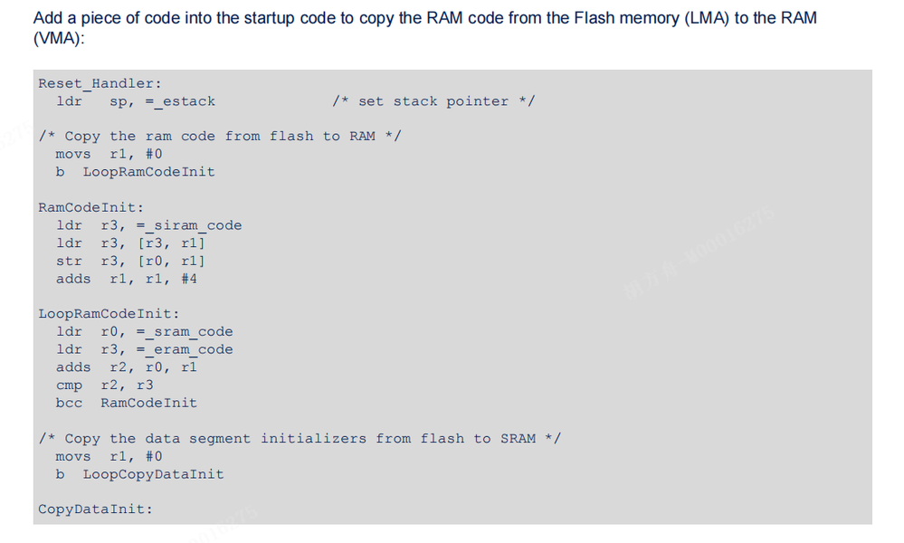

I wanted to know how to speed up the execution by putting the code in RAM.
fhu.11
I learned from section 2.5.7.2 of the STM32CubeIDE user manual that it can be done by modifying the .ld flie and .s file and using __attribute__((section(".RAM_Code"))) declaration functions.
0693W00000FAJFeQAP.pngBut i still confuse in modifying the .s file. I wonder how to add these code into the .s file

The .s file in question is the startup*.s file under Startup. It should already contain the the first two lines and the last 5 lines (starting with the comment "Copy the data ...") of the code snippet you have posted. Those last lines deal with copying initialized data from Flash to RAM (like string constants in your code). The code before it (starting with the comment "Copy the ram code ...") does the same for your attributed function's code. So you have to insert all lines starting with "Copy the ram code ..." and ending before "Copy the data ..." from the snippet right before the "Copy the data ..." in your startup*.s file.
Note: My startup file starts a little differently:
Reset_Handler:
  ldr   sp, =_estack    /* Set stack pointer */
/* Call the clock system initialization function.*/
    bl  SystemInit
Leave all existing lines in the .s file, just add the code copying loop as said above.
