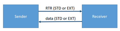

I am very new on coding and CAN,so can I respond the frame using the button in the Nucleo F103RB?For example,the receiver(RTR)is going to send a request with an ID using TxHeader.StdId = ID right?With this id,the other other board will see the id and send a message,wich the reciver can store right? Thank you for the answer!

The receiver will receive an RTR message with an ID (standard or extended). It will answer by a data message that the sender needs to catch (the filter needs to be configured accordingly in both sides: sender (ID) and the receiver (RTR+ID)).
Hope it's clear now.
