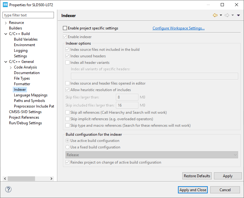

I redo some tests this morning and as I see the issue seems to be located in the editor it self, for instance a 'DEBUG' symbol that is not defined in release is still considered. Compiled code seems to be ok. Have look in the attached in the screen capture.
‎2020-04-18 7:52 AM
Aha. This actually looks like indexer issue: it does not follow the active configuration, so the #ifdef'ed section remains shadowed.
Try to re-index and check the indexer settings in Eclipse.
-- pa

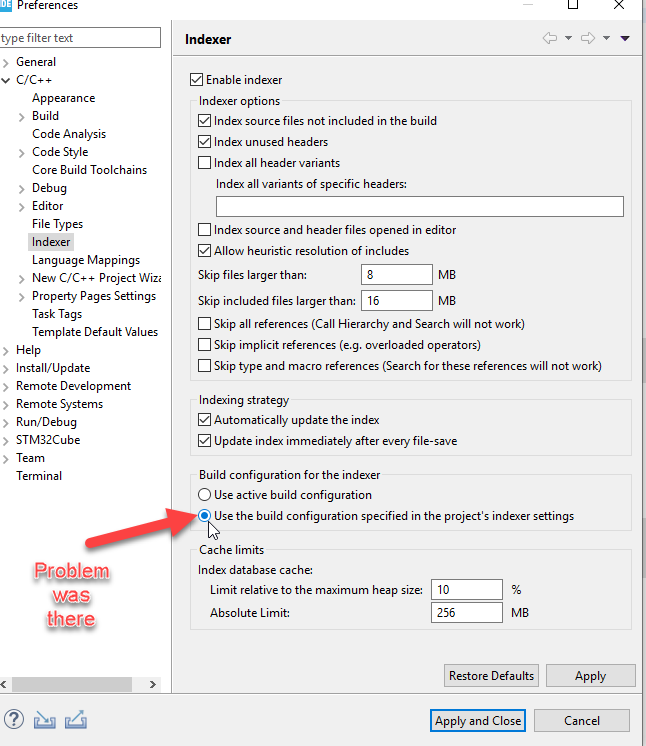

‎2020-04-19 1:50 AM
:grinning_face:
changing to 'Use active build configuration' fix my problem.
When I look in the project indexer I cannot find explanation of the previous behaviour or maybe I'm not looking at the right place ;)
I have the impress that the project settings was referring to general settings and general settings was referring to the project settings...
