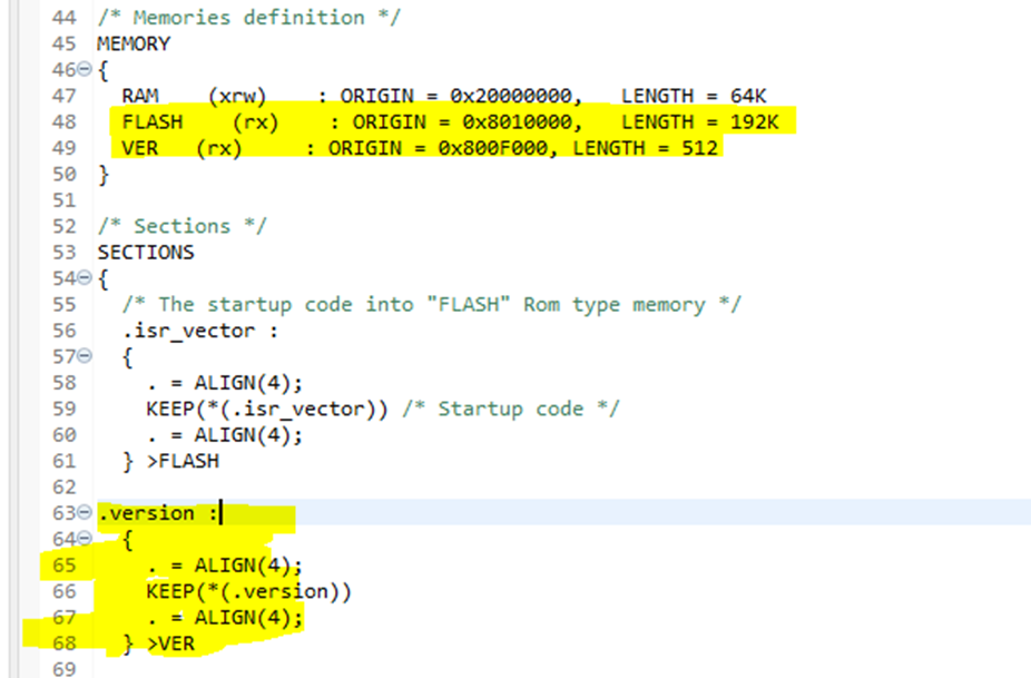

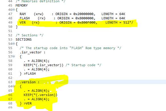

i don;t know how to locate a variable at a specific address using an ld file and the __attribute__ ((section)) attribute in your code on an stm32f105xx MCU.
PHoju.1
in ld file
but this way it is possible
why? ​
