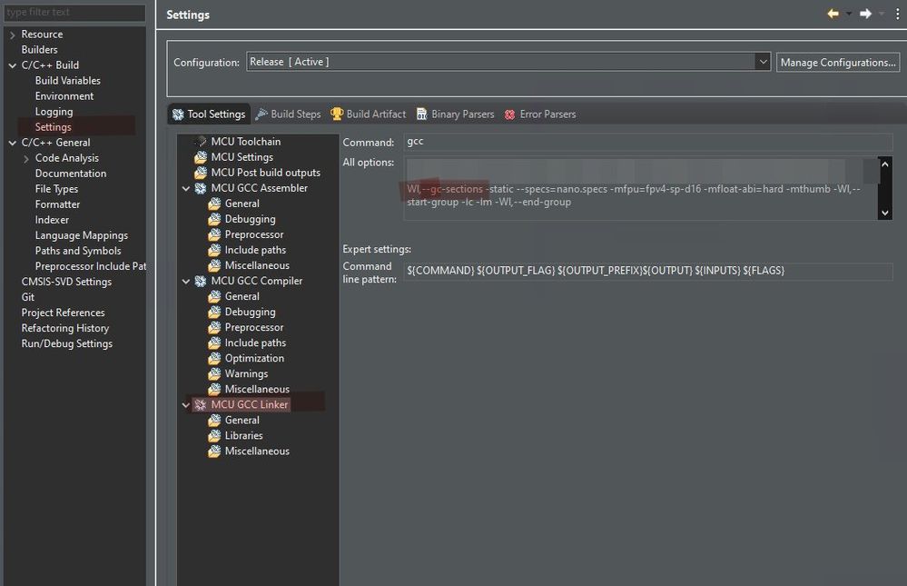

July 2, 2024
Sure, but the default compilation flags under Cube already specify -ffunction-sections and -fdata-sections, I don't think anything manual needs to be done. I've worked with and modified the linker scripts in the past (to reserve a section of flash for NV storage for example), but I don't remember seeing anything there that explicitly handles these sections. I wonder how it works on the nitty-gritty level.
Just FYI, these options are very common optimizations used in embedded context. I've also seen them elsewhere outside the STM32 ecosystem.

July 9, 2024
> 'used' attribute Appears Ineffective.
But it's not ineffective. It works as intended. You're compiling with -fdata-sections and --gc-sections, so you're explicitly asking for the variable to be pruned. You can't blame the toolchain for doing exactly what you're asking it to do, and you can't call the attribute ineffective because of it.
 >  In addition, if the same source (with 'used' attributes) was ported to a toolchain that did support 'used'
> (e.g. TI arm clang) it would not need further linker instructions.
This would surprise me. Have you really tested this claim against TI's compiler (with the same options compiler/linker)?
Because from what I understand, other compilers would behave in the same way. i.e. specifying --gc-sections explicitly asks the linker to ignore the used attribute. If the `retain` attribute is not available, manually adding a carve-out in the linker script is probably the best you'll get.
It's also possible (untested) that you could get what you want by using the `section` attribute instead.
If you manually place the variable in a section that contains any other used variables, it should not get pruned.
Also, the use case you gave earlier was that of a version string kept a fixed memory location in a bootloader. But there would be no need to make the variable static in that case (in fact, exporting it as a symbol would be good documentation), and you could not get it to be at a known fixed location with manually manipulating the linker script, anyway.
