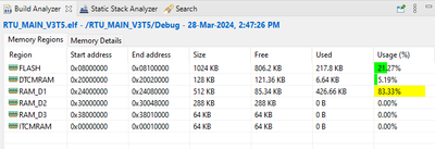

Hi All,
I want to use DTCRAM in stm32cubeide, the controller i used is stm32h743, earlier I
Used RAM_D2. shifting from RAM_D2 to DTCRAM is possible but both i cant use,
please guide me,
/DISCARD/ :
    libc.a ( * )
    libm.a ( * )
    libgcc.a ( * )
  .RAMD2buffers(NOLOAD) : {
    . = ALIGN(4);
    *(.buffers*)
  } > DTCMRAM
.bssDTCMRAM(NOLOAD) : {
    . = ALIGN(4);
    *(.buffersDT*)
  } > RAM_D2
  .ARM.attributes 0 : { *(.ARM.attributes) }
the above code is added to linker file,
//__attribute__ ((section(".buffers"), used))
char rData[BUF_SIZE];// Read data
uint32_t DMA_ADC1[ADC1_Size];
uint32_t DMA_ADC2[ADC2_Size];
uint32_t DMA_ADC3[ADC3_Size];
__attribute__ ((section(".buffersDT")))
uint32_t DMA_ADC3_dummy[ADC3_Size];
this code added to main file,
thanking you
Pick less ambiguous patterns.
File is processed in-order, variables need to be used or dead-code elimination will discard them

If My syntax is right then what could be the probable reason,
    . = ALIGN(4);
    *(.buffers*)
  } > DTCMRAM
    . = ALIGN(4);
    *(.buffersDT*)
  } > RAM_D2
 In above OP,  this works

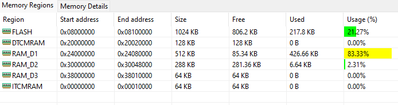

the memory located in DTCRAM for " buffers" only. but what about bufferDT, Tha aRAM_D2 showing noting. If I Invert the DTCMRAM And RAM_D2 as shown in below
 /DISCARD/ :
    libc.a ( * )
    libm.a ( * )
    libgcc.a ( * )
    . = ALIGN(4);
    *(.buffers*)
  } > RAM_D2
    . = ALIGN(4);
    *(.buffersDT*)
  } > DTCMRAM
the Analyzer graph
From above. I can say that only first section get into account by compiler and second one discarded.
please guide me.
thanking you
Pavel A.
Pattern *(.buffers*)  is before *(.buffersDT*) in the script, so it captures the latter. Move the 2nd section up above the 1st one.
