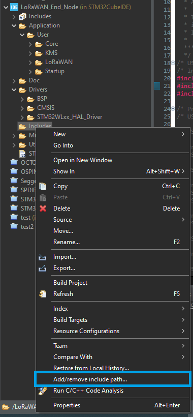

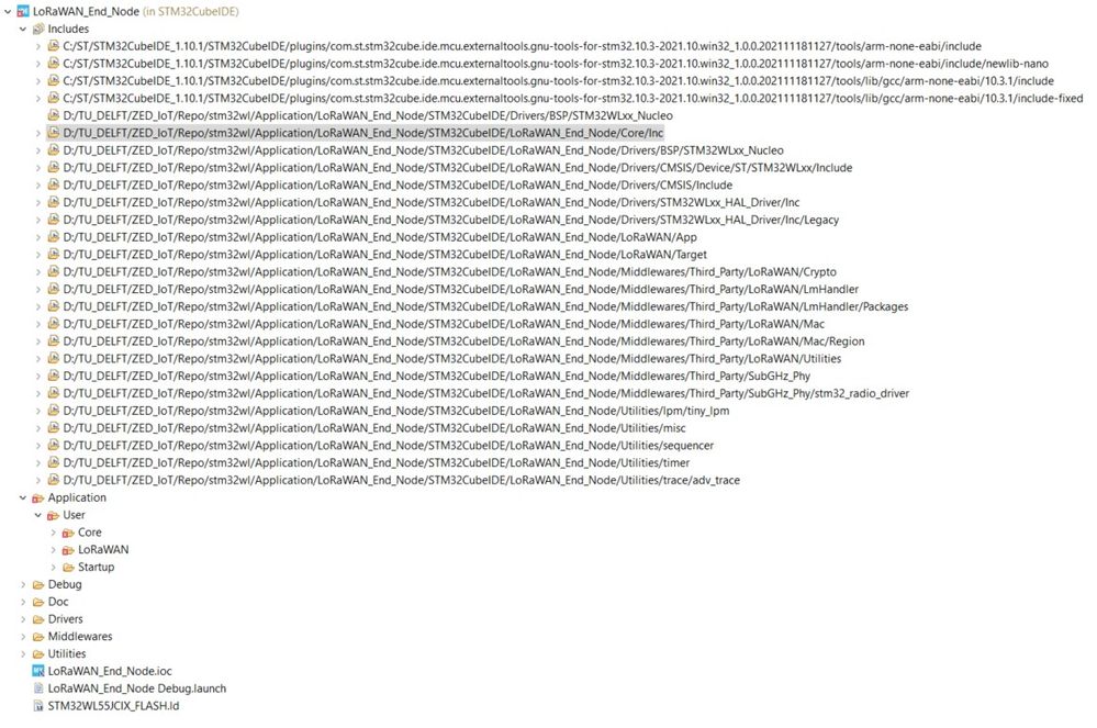

I have a question about how to update Includes folder in a downloaded example from STM32 CubeMX.
Currently, I am working with LoRaWAN_End_Node example downloaded from STM32 CubeMX for the board Nucleo-WL55JC1. Based on that example, I want to add some of my files (both header and source files).
I want to ask how do I update Includes folder when I put new header files in the Inc directory (Inc is not shown in the Project Explorer tab).
I hope to have help from people in the community.
Thank you, Huy Nguyen.

Hello Semer,
My apologies for replying this late. I solved my issue already. It turned out that I looked at the wrong directory. That was why I could not see my newly created files.

I added the header files to the Inc directory already but the Includes in STM32CubeIDE has not been updated yet (I dont know how to do it).
Semer CHERNI
Hello @Community member​
In this case I would propose the following
  • Add a folder under the project in CubeIDE and name it as you want (for example "Includes")
  • Right click on that folder and click on the "Add/Remove Include Path..." option"
  • Add your header files under that folder
Kind regards,
Semer.
