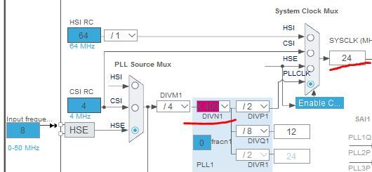

I am using a NUCLEO-H743ZI board.

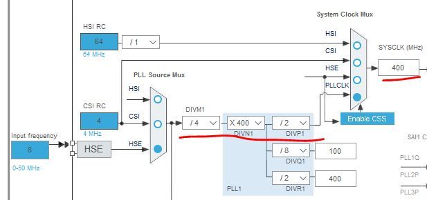

Using STM32CubeMX, I was able to set SYSCLOCK to 400 MHz like so:
With STM32CubeIDE, it won't allow me to do the same:
What should I be doing here instead?
STM32CubeIDE has been really frustrating.

I found similar - it kept knocking DIVN1 back from *8 to *7 on me.
