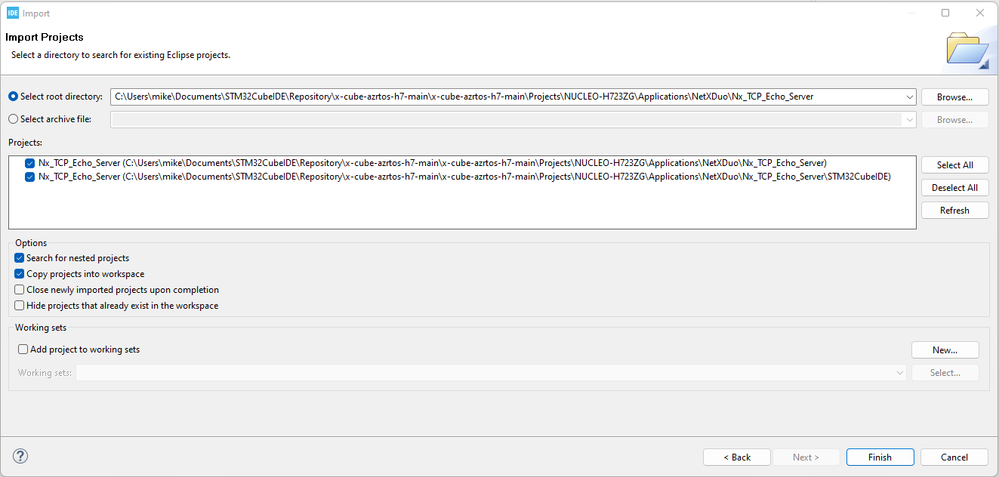

Still struggling with this. Let me clarify.
I am attempting to "import" an existing example project from my repo (means COPY code into my workspace, not link to external code in my repo). The repo files were downloaded from GitHub (x-cube-azrtos-h7-main). The workspace I want the imported projects to be copied into is workspace H7, which is the currently active workspace of CubeIDE.
There seem to be two ways to do this. Not sure now these are different.
  1. Import->Existing Projects Into Workspace.
  2. Import->Projects from Folder or Archive.

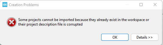

When using technique #1 I get two "projects" in the import window:
0693W00000aIamQQAS.pngIf I select BOTH projects, I get the following error message.

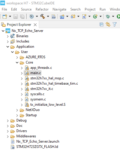

0693W00000aIam7QAC.pngHOWEVER, the projects have been imported and all example files do exist in the workspace H7.
BUT, the build hammer is greyed out and i cannot build the project.

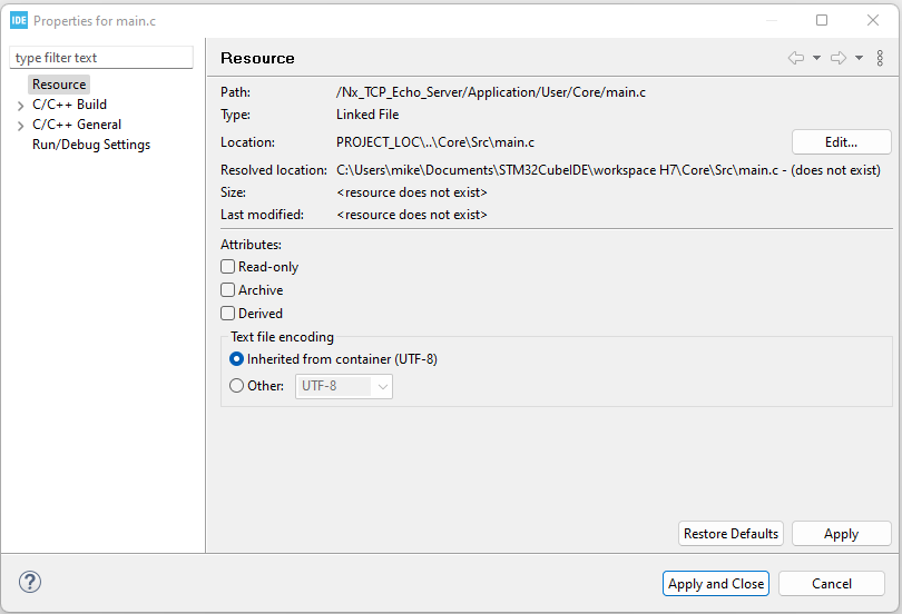

So if I erase the ..metadata file and all contents on the workspace H7 folder, then attempt to import ONLY the STM32CubeIDE project, I get the following. The yellow exclamation point apparently means the "file does not exist".
0693W00000aIasYQAS.pngThis is confirmed by looking at the "resource" in the project properties window (resolved location).
0693W00000aIavDQAS.pngUpon examining the workspace H7 using windows file explorer, I find that none of the files have been copied over. So apparently I DO need both projects, but am not able to import them because CubeIDE still thinks they exist in the workspace H7???? And the build hammer is greyed out??

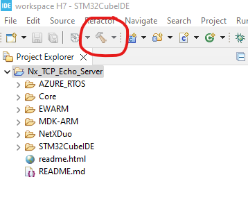

After importing using methods #2, i get the following project file structure.
0693W00000aIb0wQAC.pngOnce again, build hammer is greyed out so that I cannot build the project.
WTF?

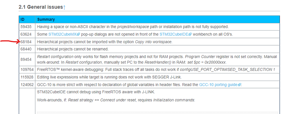

So, here is part of the problem I am seeing. I guess this renders "hierarchical" example projects useless until this is fixed.

Try to only import the project as is, since it is already a CubeIDE project.
Let's do it again, slowly, step by step, with latest CubeIDE v.1.12 and STM32H7 libraries already installed.
1. Take a clean saucepan. Create a new directory for the workspace or carefully delete remnants of the project from existing workspace.
2 File->Import->General-> Existing project into workspace
(not "from folder or archive" etc.)
3 Browse to .... Repository\Packs\STMicroelectronics\X-CUBE-AZRTOS-H7\3.0.0\Projects\NUCLEO-H723ZG\Applications\NetXDuo\Nx_TCP_Echo_Server
or copy & paste the path.
Note: the cube repo path (and therefore the project path) must be spaces-free. Else, move the cube repo to spaces-free path.
Then Eclipse should see one and only one project in the STM32CubeIDE subdir.
Do NOT check "copy projects into workspace".
4 Click Finish.
The project imports without a hitch.
5 Click Refresh, Build (the hammer icon)
The project builds without a hitch.

Finally to answer your question: How to import example from GitHub?
AFAIK this is straightforward only for examples where all components are in the "jumbo" MCU package available on github,
Your example cannot be installed just by clone or download from github, because it uses additional pack X-CUBE-AZRTOS-H7.
It needs the CubeIDE "pack installer" magic to get these X packs into the correct places.

"1. Take a clean saucepan. Create a new directory for the workspace or carefully delete remnants of the project from existing workspace."
Done.
"2 File->Import->General-> Existing project into workspace
(not "from folder or archive" etc.)"
Done.
"3 Browse to .... Repository\Packs\STMicroelectronics\X-CUBE-AZRTOS-H7\3.0.0\Projects\NUCLEO-H723ZG\Applications\NetXDuo\Nx_TCP_Echo_Server"
Done.
"Note: the cube repo path (and therefore the project path) must be spaces-free. Else, move the cube repo to spaces-free path."
Done.
"Then Eclipse should see one and only one project in the STM32CubeIDE subdir."

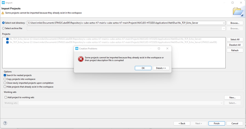

NO! There are always two projects shown in this window. So apparently, this example is a "hierarchical" project. Below is what I see.
0693W00000aIipmQAC.pngIf I then click on "Finish" I get the following error message.
0693W00000aIiprQAC.pngThis happens every time, even with a clean (i.e. no files) in the newly created workspace.
