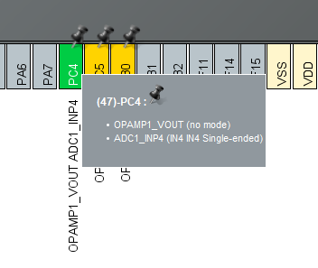

Within IOC if I select OPAMP1 I see PC4 has OPAMP1_VOUT in green and PB0 has OPAMP1_VINP in green.

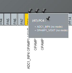

Moving to ADC1 I can select IN4 as OPAMP1 Output Single-ended and that appears in yellow under the pin allocations.
ADC1 still shows a yellow triangle.

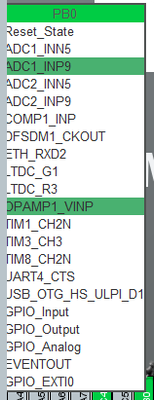

It suggests the following to remove the yellow triangle:
This seems to suggest that I should connect ADC1_INP9 to the same pin as the opamp input? That doesn’t seem correct to me. However if I do select that both are now highlighted in green
Yet the important one, PC4, OPAMP1_VOUT is green yet the ADC input, ADC_INP4, is still yellow?
In summary I think this is a question in two parts, how do I connect the OPAMP1_VOUT to ADC_INP4?

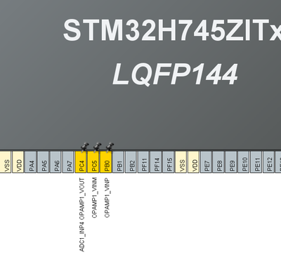

1°) To be able to configure the OPAMP1 and ADC1, you must first configure the GPIOs in the Pinout View.

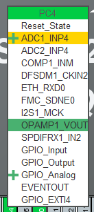

Right Clic on PC4 and choose OPAMP1_VOUT.
Right Clic again PC4, then press Ctrl and choose ADC1_INP4.
Right Clic on PC5 and choose OPAMP1_VINM.
Right Clic on PB0 and choose OPAMP1_VINP.
2)° Then select ADC1, enable Cortex-M7 (or M4)
Enable IN4 Single-ended, PC4 change from yellow to green.
3°) Then select OPAMP1, mode PGA Connected-INVERTINGINPUT_IO0.
PC5 and PB0 change from yellow to green.
