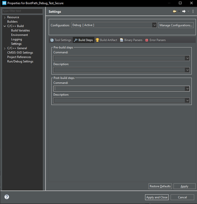

I have a Bootloader and Application Project using STM32F030CCT6TR controller with 256KB flash.
I am using 32KB for Bootloader starting from 0x8000000 address and Application of 220KB from 0x8008000 address.
Can I generate a unified hex file to program controller with Both the Project with their respective addresses in STM32CubeIDE.
Solved! Go to Solution.
2023-11-03 7:01 AM
Hello @TShet.2
ARM provide an utility to merge hex files you can check it from ARM web site.
If you could run this command line successfully, you can make an automatic generation by adding it to the build configuration : Post build command.
BR,
Semer.

If you can use an editor or write an AWK script, or a basic C program app on the host system, you can probably just merge the two, striping the terminating line on the first, and appending the second file.

2023-11-03 7:26 AM
Yes, they are point to SRecords, a HEX file tool. But in all honesty the formats are pretty trivial. It's the terminal record in the Intel HEX format that you need to remove when concatenating files.
Do it once, or twice, in an editor to understand the mechanics, and then automate.
2023-11-03 7:39 AM
STMCubeIDE is multiproject Eclipse envi , then you have one project for bootloader in same workspace next project app. What you setup into build or run sequence result to create one hex for every project or more hex based on scripting etc.
2023-11-04 1:40 AM
As alternative to external tools, is to write a top level linker script and let GCC (linker) do this job.
