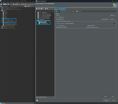

Whenever i rename a project. launch file is created and a number of. launch files are generated for each project name, is it possible that automatically that the old launch files are deleted, i can delete manually but just checking if it can be deleted automatically as soon i rename the project.

The launch file take it's name from the debug Debug Session name:
Also to delete the launch file you just delete the debug configuration having the same name.

Haven't seen any automatic delete on renaming. In fact, one can have several launch files for different configurations, so there is not necessarily a 1:1 relation between .lauch name(s) and project name.
