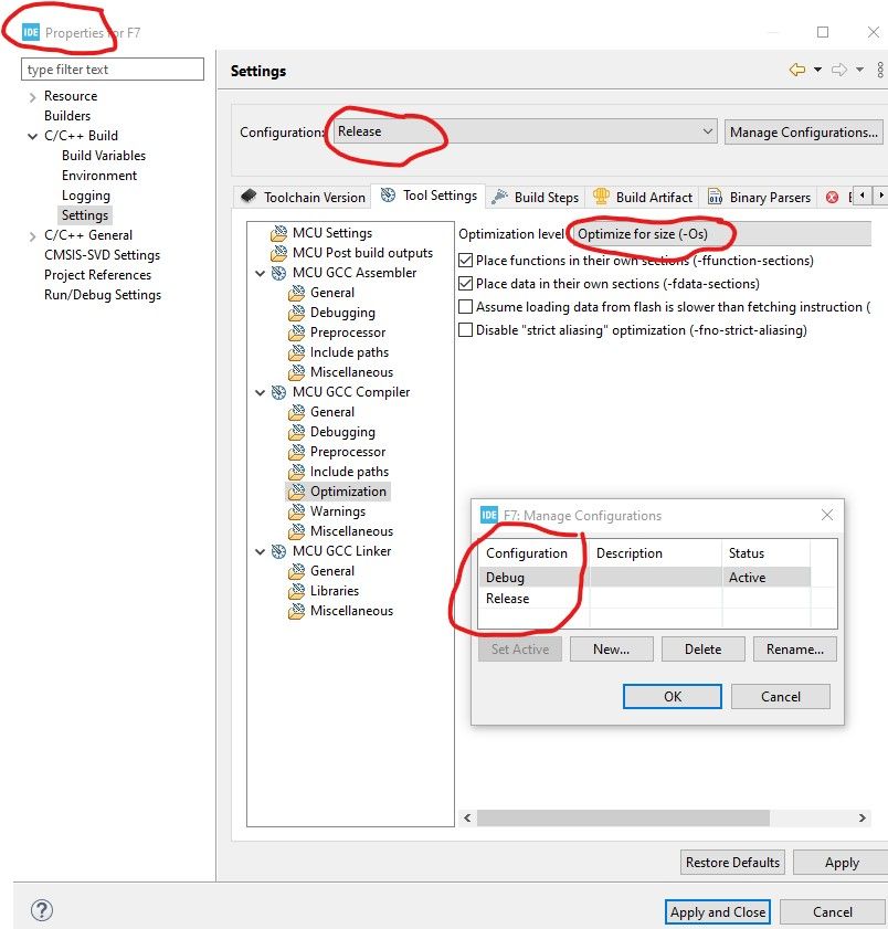

If STM32CubeIDE created project at least you have by default x2 build configurations promoted by default. They are called quite explicitly ie. "Debug" and "Release". Main diff is compiler optimization setup. One is keeping debugger required data, second is leading to most optimal binary. Up to you to refine what's most optimal means (size, speed, ... optimization) if you want.

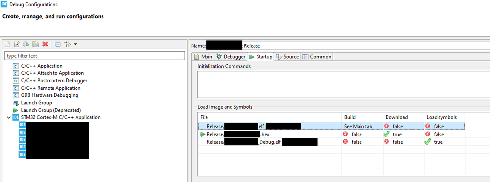

To make the Debugging Process work you have to edit your debug Configuration in the following way:
0693W000007BNkCQAW.pngSo you load the Symbols from the unstripped File.
So it worked that way and was nice but than I checked the Hex Files.
And as KnarfB pointed out, there is no Debuginformation in the .hex or .bin File.
I also checked this with the script created Hex file above, the Normaly created Hex File in "MCU Post build objects" and additionally in a Build with maximum and none Debug information. They were all the same.
So Year... I will just revert the Project changes and use the .hex/.bin and everything is fine.
