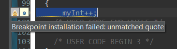

Hello. I am currently working on a NUCLEO-L152RE project in the latest version of the CubeIDE. I am running into an error where I can not install break points due to an "unmatched quote". I have tried the common fixes (New work space) for this that I could find online and it hasn't resolved it. I also ran fresh installs of the programs and encountered the same issue. Has anyone else encountered this problem? I have included a screenshot below for reference.

Maybe there is an unmatched quote in the file or a file it includes. It's unlikely to be making things up--this is parsed, not AI.
I am using the 2.0.0 Build of both the IDE and MX software. I used the MX file to generate the initial code and then added some generic lines (incrementing an integer). This is the second project I have created using the MX and they both have the same problem. I am running the software on a Windows 11 set up. As far as I can tell everything functions properly except for the breakpoints.

As far as specific steps, I generated the initial file in the MX (ver 2.0.0). I then opened the project in my CubeIDE workspace (ver 2.0.0). Then I added two lines. The first declared the variable myInt and set the value to 0 "uint8_t myInt = 0;". The second increments myInt in the generated while loop "myInt++;". I only get an error when I add the breakpoint to any of the lines in the main.c file, using both the add breakpoint option and double clicking the line number.
Adding the breakpoints generates the message, I am getting no other warnings or errors. It has effected every .c file in multiple projects that I have worked on.

Are there any spaces or other "special" characters in any of your file or folder names?
PS:
Just found this, reporting the same issue in another Eclipse-based IDE, where spaces in the path were, indeed, the problem.
Spaces and other "special" characters are an all-too-common source of grief and weird behaviour - see here.

Yes, in the Debug perspective I set the breakpoint after adding/building the files.
This is the file path shown in the IDE
This is the file path as shown in the explorer.
I will remove the spaces in the file names and see if that fixes it.
I added a PS to my previous post - it looks like the single quote might also upset things...
Check also what "OneDrive - Personal" actually translates to ...
