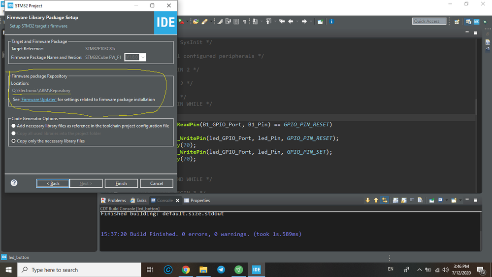

Hello community, I have a problem with new project creation, whenever I want to create a new project I come across this error: create minimal project failure: cannot read template source. reason: internal error
i know the problem which is having a space in my user folder name which i don't wanna change because it might mess my registry files.
so i'd like change the repository location to another place if it's possible.

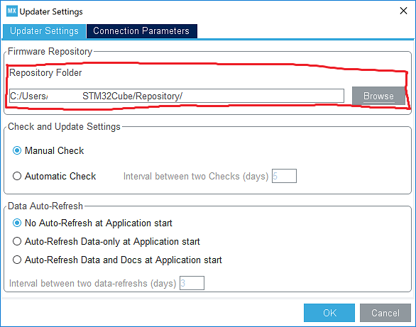

In STM32CubeMX, you can navigate to Help -> Updater Settings to change the repository directory. I don't know if this will carry over to STM32CubeIDE, but it may.

I changed that but it did't help
i find a way to change "Firmware package repository" in CubeIDE when creating project and still nothing
I'm getting mad, it's been 4 days i'm dealing with this thing, i don't know what to do...

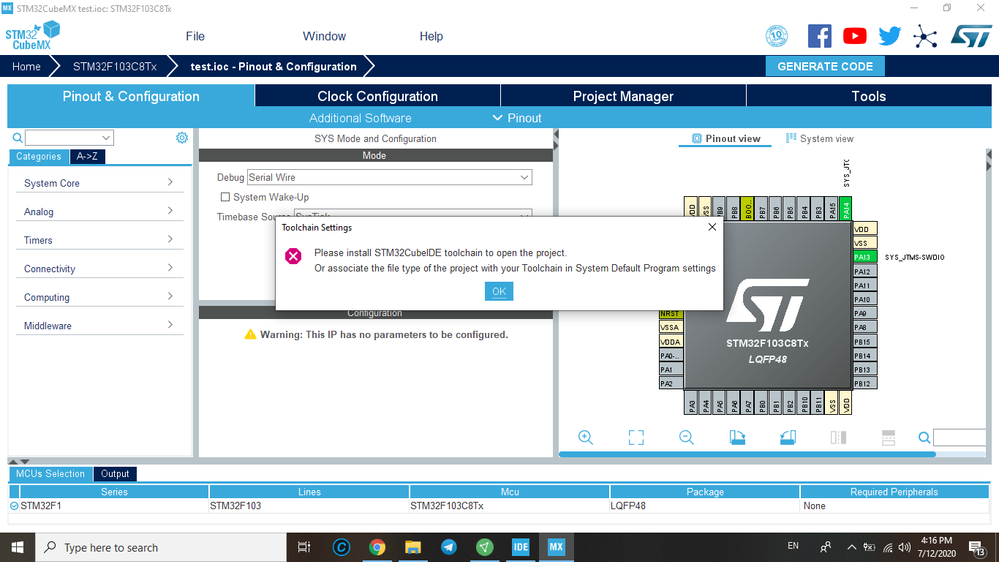

another thing: when i'm trying to create the project from standalone CubeMX, this error pops up, thank you very much!
and I have installed the CubeIDE!
i'm not sure what i'm doing wrong...
