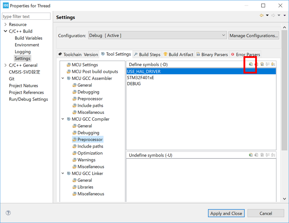

‎2019-08-02 10:32 PM
To add preprocessor symbol is...
- Right click on your project -> click Properties.
- Select C/C++ Build -> Settings -> Tool Settings tab -> MCU GCC Compiler -> Preprocessor.
- Click Add Button and input your symbol.
