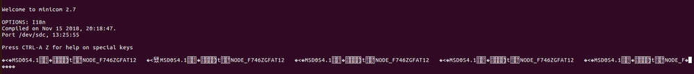

How should I set the config of minicom to get the correct message from NUCLEO-F746ZG?
Ellaine
I have searched lots of articles, and followed their approach, but minicom still show garbled. (I tried teraterm on windows before. Its message is correct.)
The following is my command lines:
$ sudo minicom -s
Serial port setup >
  | A -  Serial Device   : /dev/sdc
  | B - Lockfile Location   : /var/lock
  | C -  Callin Program   :
  | D - Callout Program   :
  | E -  Bps/Par/Bits    : 115200 8N1
  | F - Hardware Flow Control : No
  | G - Software Flow Control : No
I'm pretty sure the config is equal to my USART3 setting:
/* USER CODE END USART3_Init 1 */
 huart3.Instance = USART3;
 huart3.Init.BaudRate = 115200;
 huart3.Init.WordLength = UART_WORDLENGTH_8B;
 huart3.Init.StopBits = UART_STOPBITS_1;
Is there any step I lost?
/dev/sdc is a hard disk or some other mass storage device. You are actually seeing its boot sector in the terminal. Try with a serial port instead.

I changed "/dev/sdc" to "/dev/ttyACM0", and it showed the correct message. Thanks.
