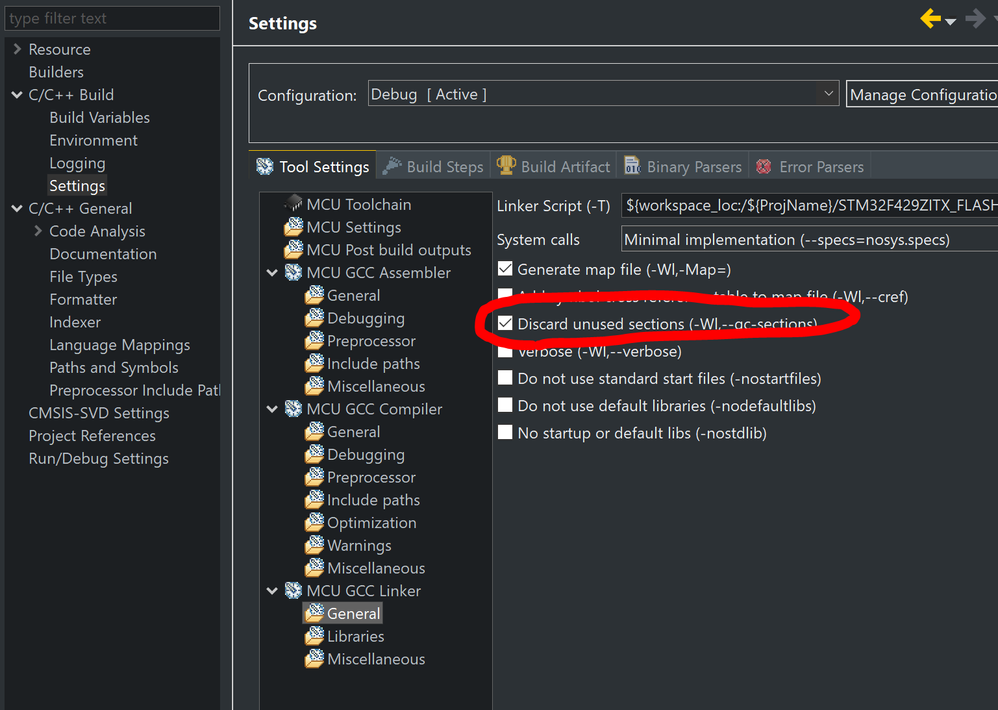

Not sure, but if I don't use printf, it doesn't appear in the map file. Are you sure it's not being used somewhere in the program? Is the replacement printf include appearing before all instances of printf?
There is this checkbox, but it had no effect for me when I tried it with printf.
As a note, I use the same printf replacement in my code. It works well.
‎2022-04-29 7:24 AM
That box is checked.
I did a global search for "printf" and don't see anything in the project other than things like vsnprintf_ that is in the third party library I mentioned.
I would have thought this would be trivial fix. I don't see a way to disable the nano lib, seems like it gets included in some form.
